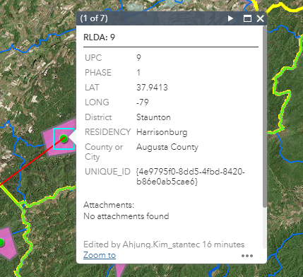

I have a feature service and a related table linked by a text field (hosted on AGO).  I understand that global ID - guid link is ideal for creating relationship classes, but this was unavoidable for the project.  I am opening the S123 from URL with the primary key field pre-populated with string value.  It is set as read-only in S123
I am able to successfully submit the survey.  However, the feature point created via S123 submission shows a global ID in the primary key field (UNIQUE_ID field) below.
Am I trying to do something unsupported by S123 here?  Should relationships be created using only GlobalID-GUID fields?

Addendum: This only happens with web form (works as it should if data is submitted from native app).

I've been able to replicate the problem and have filed an issue to resolve it.

The bug number for this issue is BUG-000119623.

Thanks for the feedback. This bug has been fixed internally and will be out in our next version 3.5 release at end of June. Would you please have a try then?
