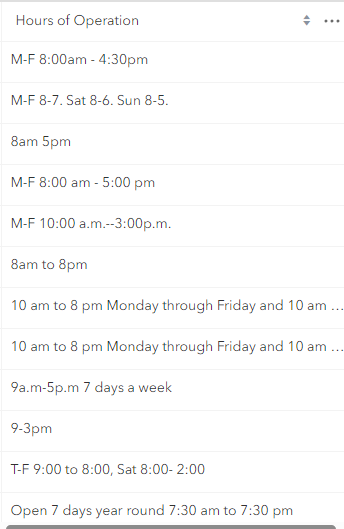

I'm currently developing a survey that will be used to prompt local businesses. The business owner will be able to include various data about their business including hours of operation. Currently, there is a lot of variation in the hours of operation submission format. (see the image below)

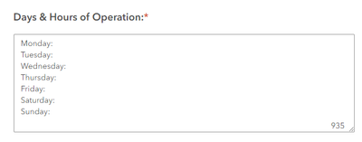

I'd like to eliminate as much variation as possible. I came across a public survey in my searches and would like to do something similar. It looks like they have a multiline text box with the days of the week prefilled.
Does anyone know how to accomplish this in connect? I'm open to other ideas too! Any information or assistance would be greatly appreciated. Thanks!!
