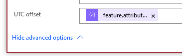

Press "Show advanced options" and use this:
You will need to collect UTC offset in your survey and pass that into this field. That will automatically correct the times.

Thank you for the above response.  I am working in the Create Report and my screen looks a little different.  I put in my time field from the survey under UTC offset and the time didn't change.  Any ideas?
