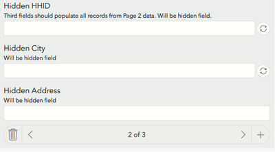

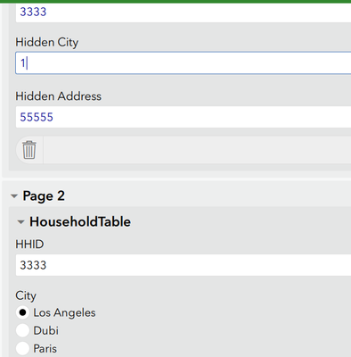

I am having difficulty populating fields between repeats. My workflow is as follows: First, several records are created in Repeat 1. Secondly, one record (w/multiple fields) is entered into Repeat 2. I need the fields from Repeat 2 to populate all records created in Repeat 1. Currently, only the last record in Repeat 1 is being populated. The remaining records have a refresh button. The problem with the refresh button is that the fields will be hidden. I have tried a couple of different approaches: calculating the field outside of both repeats and using the  indexed-repeat formula. Neither seem to work. Maybe some JavaScript function might help, but I am not familiar with writing JavaScript. Any help with this will be greatly appreciated. Attached is an example file.

I think it is the using a field called calculation.  I changed it to calculation22 and now it works.  It is not on the reserved list but I would not use it.

Thanks for taking a look, I should not have used "calculation" as as field name. I made the change as per your suggestion though if you add multiple people before adding the HHID/City on page two only the last person
repeat will be populated with the values. The other records in the repeat have a refresh button next to them.AndrewPadilla_0-1620409003752.png
Since they will be hidden fields they will not recalculate once created. As a work around, I ended up putting a relevant HHID and City field before the Person repeat which populates the hidden HHID and City fields. I was trying to avoid having to create extra fields but ended up doing so this time. Attached is a revised example. Thanks again for taking a look.
