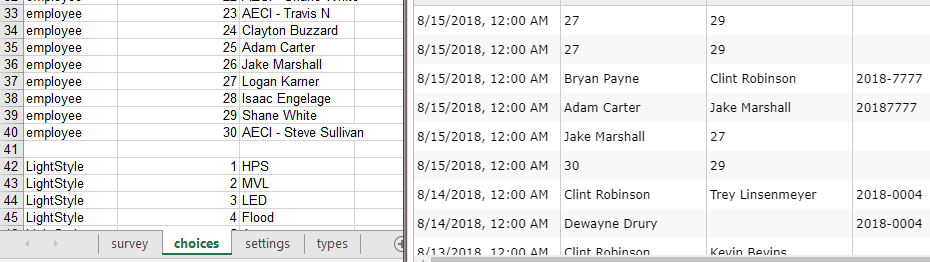

I've got a Survey with a picklist that works great until it gets to number 27. After 27 the data table only shows the number rather than the name.
Luckily, when I generate a report the field is populated with the name instead of the number.
But still. Why the change? Do I have something set up incorrectly?

After testing, it looks like I'd be safe to assume that you have added choices to your choice-list after the initial survey creation/publishing, and then republished?
If this is the case, the behavior that you are seeing is likely related to the fact that Survey123 Connect does not update the domain after the initial publishing of a survey.  It looks like the choices that you added were choices '27' and beyond.
[Revised from original] There is a way to manually update the domain by navigating to the Item Details page of the feature service and clicking on the Fields view. From here, you should be able to click on 'Installer' and 'Second Installer' and add the values to the domain.  So, you would add the Code '27' and Label as <installer name>, etc..
In the meantime, I will add your experience to an existing discussion in our backlog related to this behavior.

Can you please provide your XLSForm so that we can take a look?  Also, the version of Survey123 Connect that you used to publish the survey and the method that you are using to submit your surveys (web app/field app).

AprilChipman
The Survey123 Connect version I re-published the survey with today is 2.4.60. I made the Survey months ago and I'm sure it was under a different version of the software.
The survey is completed using the field app. The test ones I did this morning were on an iPad.
Here are some screen shots...
BrandonArmstrong
Best,
Brandon
AprilChipman
YES!  Brandon this worked beautifully!  Thank you so much!
