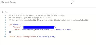

If you were accessing the survey link in a feature layer pop-up you could use Arcade to calculate the coordinates and construct the survey URL. Perhaps you can try a similar approach for your survey link?

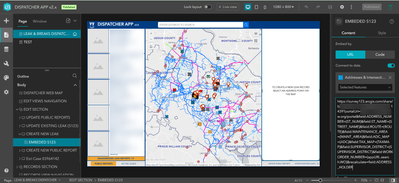

I rigged up Experience Builder as follows:
  1. The search widget searches for addresses and selectes the first candidate
  2. The selected features attributes are used for the embed widget
  3. The embed widget uses URL parameters to prepopulate a survey with the attributes of the selected feature
There is a glitch though. I have a geocode question in my survey which takes the address (passed in from the selected feature), runs a geocode, returns the XY and centers the new survey point. However, as the address is technically PRE-populated before the survey is even created the geocoder fails to fire. Manually editing the address, even to just remove a single address number and replace with identical, then causes the geocoder question to wake up, fire and return the XY centering the survey point. Additionally I can trigger if off any other question which is NOT pre-populated.
There is a recalculate URL parameter that I’m using to try to get the geocoder question to fire after the survey is created but it dens't seme to work. I'm using the syntax:
“&recalculate=field: ADDRESS_HOLDER”
If anyone can offer some advice on how to get the geocoder question to fire with PRE-populated values I would appreciate it.
