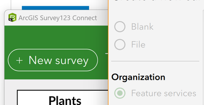

One good way to troubleshoot is point Connect to the service and let it build a form.  Then compare that to yours.

Do this
DennisBalster
Thanks for the reply!
When I do it that way, Survey123 refers to the wrong layer and the wrong related table. I then change it to the correct layer.
The strange thing is, as I mentioned in the text above, that I had successfully published the survey before. I had to make some changes to it later, but now it doesn't work at all.
