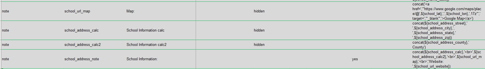

Todd
Here's the fix... and the '<br>' tags are working in Edge.
Regards,
Todd

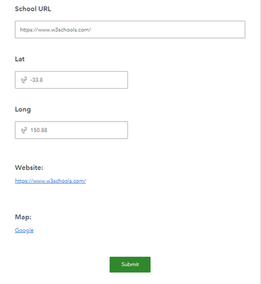

Alber_Verster
Hi Todd,
I would recommend that you use the Concat() function in the calculation field as the Survey123 webform can be problematic is these cases.
Once I inserted your HTML script into the calculation field, I was able to display the hyperlink correctly in both the Field app and the webform.
concat('<a href="',${school_url},'">',${school_url},'</a>')
concat('<a href=','"https://www.google.com/maps/place/@',${school_lat},${school_lon},',17z">Google</a>')
Hope this helps.
Regards
Alber

Todd
@Alber_Verster worked kinda. You need an extra ',' included in the map url between the lat/lon.
concat('<a href=','"https://www.google.com/maps/place/@',${school_lat},',',${school_lon},',17z">Google</a>')
The only issue I still have is embedding the new concat-ed variables in my 'hint' attribute. Once I add them back it jacks it up.
I have several variables I'm adding as you can see and by using the <br> tags it cleans up the display (versus one variable as shown above).  I notice the extra space before the address string. Maybe I need to do a concat on the entire html string?
I'm testing using Edge and not sure how to have the html breaks <br> removed. Here is an example:
concat(${school_address_street},' ',${school_address_city},', ',${school_address_state}, '<br>',${school_address_county},' County')

Todd
Regards,
Todd
