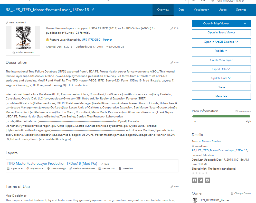

I published a new hosted feature layer (HFL) and then in Survey123 Connect (v3.1.126) created a form from that HFL.

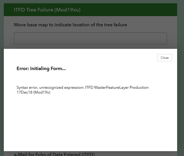

In my AGOL user account, I have the new form, but when I try to open it in the browser I get an initialization error saying that the layer is "unrecognized".
The XLXs setting workksheet matches my HFL

Hi Dudley,
I believe the problem is the presence of parenthesis in the form_id (layer name) setting.  Can you republish the service without them?
