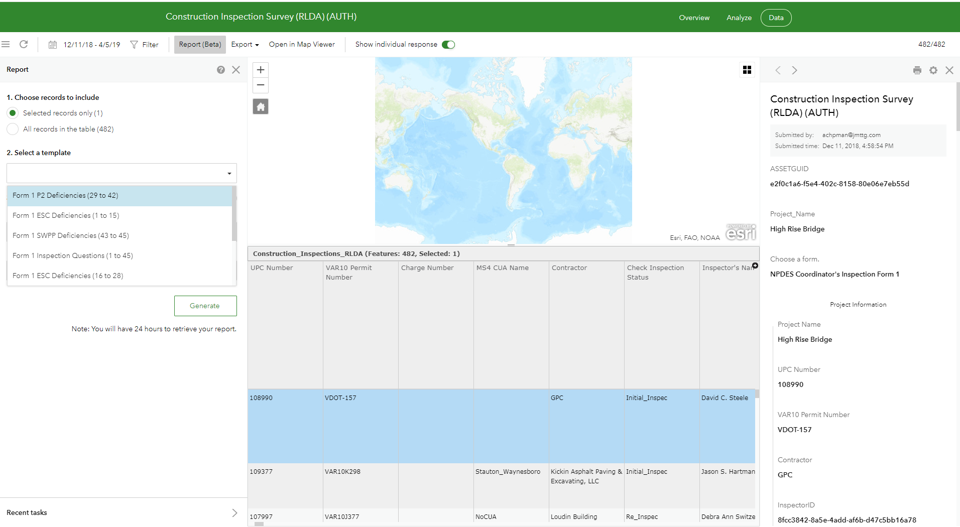

With the latest Survey123.arcgis.com  update a couple of weeks ago, I can no long "manage a template".  I need to add a custom report template to the forms when I am  looking to print a report.  I can't seem to find the "manage a template" in the print form anymore....I am not the owner of the form or the survey.  This is what I get when I select "Report".   It just disappear.  I have watch videos on adding templates and have even added a template done by our consultant before this latest update. Any suggestions:

It is by design that the 'Manage templates' options are limited to the survey owner.  This is the same behavior that has always been in place.  If you would like to add a report template to a survey that you do not own, you will need to give it to the owner to add or have ownership of the survey (including all components).
