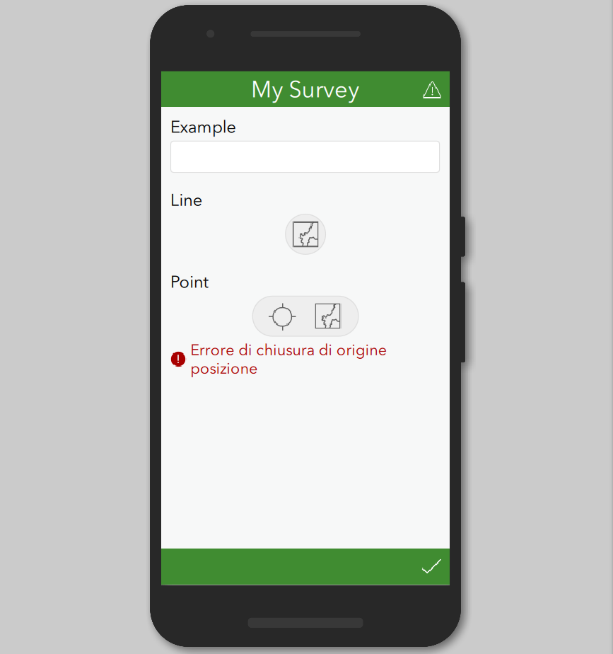

I create a new survey with advanced form and insert two geometry
  • line - main geometry
  • point - secondary geometry

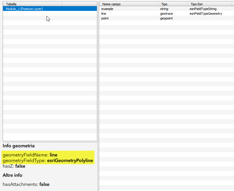

Point is only used to take position from GPS and use reverse geocoding with pulldata function for insert information in text field. And for this question esri:filedType is set to null
So in preview panel you can see that Survey123 will create a Polyline feature layer as you expect.

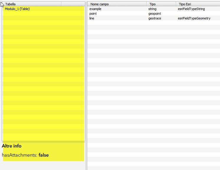

But...because there is always a but...in my complex scenario, the geopoint question comes first.
Well, whe you invert position...
...you no longer have a feature layer but a table.
