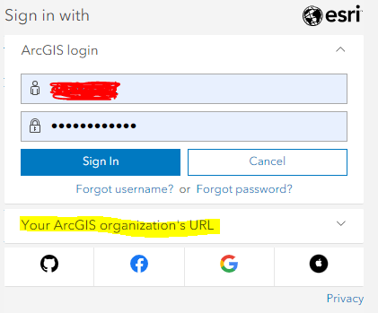

Hi,
I have previously set up 5  flows in Microsoft Power automate so that various people get emails when surveys are submitted through Survey123 using their arcgis online accounts. These surveys are all currently working succesfully.
I am now trying to create a new flow for a newly created survey in Survey123 and i am getting the error described below that i dont know how to resolve.
The surveys are stored on my arcgis online account.
In Power Automate, I am succesfully able to create a connection to arcgis online and choose my new survey from the drop down list, but then when i try to save the flow, i get the error "when a survey response is submitted url of ArcGIS enterprise is required". This is even though i am using the ArcGIS online account for the surveys and succesfuly login to this.
Any suggestions on how to resolve this error?
Thank you
BarbaraWebster1
Hi @DarraghOHagan,
We've seen this issue come up for flows created from a Power Automate template. Is the flow that you are seeing the error with created from a template? To resolve the error you can remove the 'When a survey response is submitted' module and re-add it to the flow. Alternatively, creating a 'Build your own' flow instead of a template flow will not generate the error.
