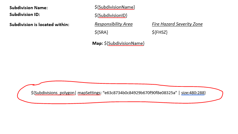

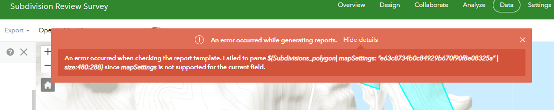

I have a feature report template, an element of which renders a basic map of the polygon record in question. The report generated just fine as recently as July. The season has calmed down, I'm back to run reports and I get an error message that says mapSettings is no longer supported.

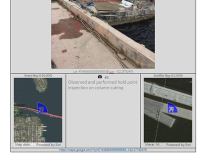

Below is a screenshot of the report template.

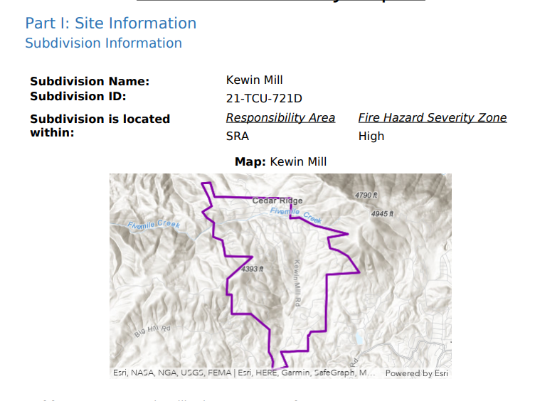

Below is the result that it produced just fine in July...
And this is the error that's cropping up now when I try to run the report....

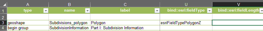

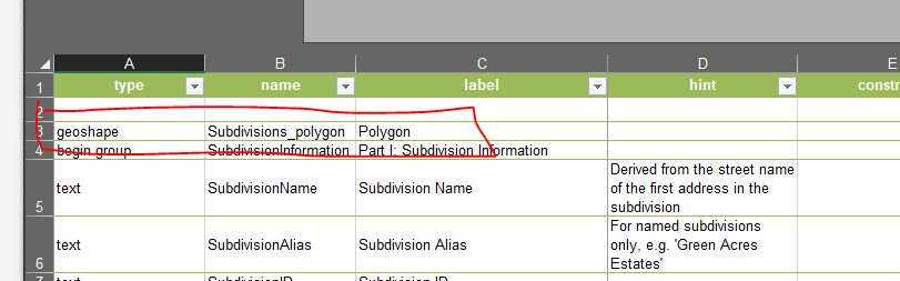

mapSettings is still listed as available in the documentation for the feature reports, and lists it as still being valid for the geoshape field. Below is the format for the geometry field in Survey123 Connect.
So......what gives? Any help would be greatly appreciated, as nothing has changed on our end for how reports were run, and we made a few hundred of these earlier in the summer.

Hi, I got the same error last week, and the solution to this question helped me fix it:
https://community.esri.com/t5/arcgis-survey123-questions/s123-error-occurred-while-generating-report...
The binding for my geopoint field was incorrect in my survey design (which didn't cause a problem a few months ago). Once I fixed it and republished the survey, the error went away.

Mine is configured as such:
The cases I've seen have expressed issues with field type being incorrect (like the link you sent) or the value being null or needing to be null. Having trouble imagining what my bind type should be other than what it is.

My fix was to make that cell in column U in the xlsform blank. I didn't change it to null or anything, I just made it empty, and then republished the survey. It seemed to fix the error, but to be honest I don't know if it's considered good practice.

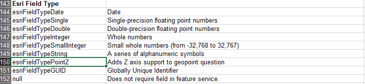

Interestingly, I don't see esriFieldTypePolygonZ in the dropdown list I would use in that cell, but maybe that doesn't matter.

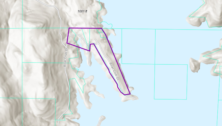

The image it pulls now....

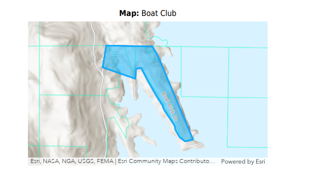

And the specified web map, which the reports used to pull from pre-update....
Maybe time to page @ZhifangWang, as they responded in the linked post, and may be familiar with the changes that have undermined things.
DerrickWestoby
Regarding the display of the map (not the error preventing report generation, which it looks like you solved) - the last survey123 update changed the way features render in your map geoshape and geotrace features (areas and lines) used to display in your map according to the visualization settings you had applied in the feature layer. This changed in the last update to a generic symbology display as the default. Theres a flag you can add to your {geoshape} call in the feature report to respect the symbology as set in your referenced map that you're calling by item ID.  sorry I don't have that handy for you right now, but its in the last survey123 blog post (within the last month).  Add that flag in your feature report and your polygons will use the same symbology you have set in the map being called by itemID.
