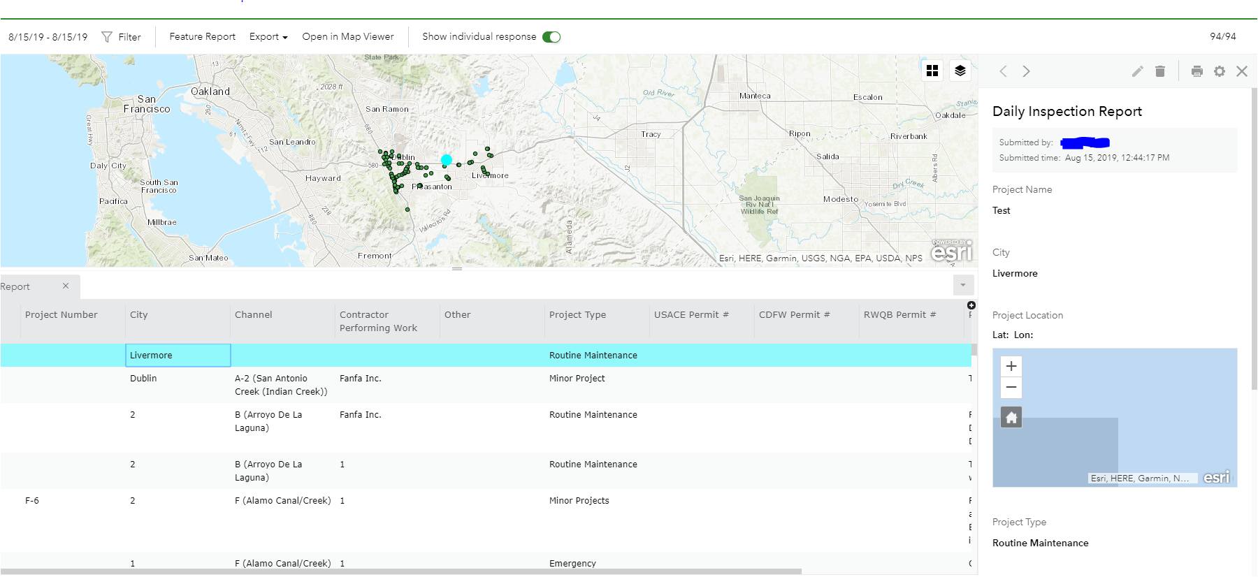

Hi,
I have configured a survey with a geopoint question in it. I can successfully complete the survey but when I view my results in the data tab at Survey123 for ArcGIS the map in the popup window is zoomed to the coast of Africa. But if I zoom to the point location there is a marker in the correct location. In my web maps the points are all in the correct location but i would like to generate reports with a map in them and i can only get them to display the ocean off the coast of Africa. Has anyone else had a similar problem.
Thanks,
Josh
JamesTedrick
Esri Esteemed Contributor
IN working with Joshua on this, it appears that the dataset was not in the WGS84 spatial reference.
