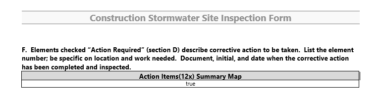

Good afternoon,
I have a few surveys that have been online for 2+ years and I have not made any changes to them in the last couple months. One has a parent layer with no geometry and a repeat layer with point features.  The other has poit features for both the parent and child layer.
Some time between 2pm PST yesterday and 6am this morning, the maps that render all repeat records stopped working (other maps for individual records still render fine).
Templates:
Work Extents
${general_notes.location_general | size:600:550:0:0 | drawingInfo:"currentLayer"}
Action Items(${count_actionitems}x) Summary Map
${photomap.geopoint | size:600:700:0:0 | drawingInfo:"currentLayer"| mapSettings:" [deleted]"}
EDIT: Photos didn't load for some reason.  See below for pictures of the output report.  Just to reiterate, these are not new forms/report templates and  these templates have been working for years via a power automate flow.

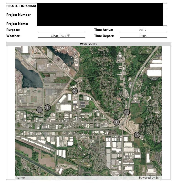

Derrick_Westoby
The pictures didn't come through for some reason.  See below.
Export 1
Export 2
This is what they should look like:
JodyZhengLiu
Hi @Derrick_Westoby , thanks for bringing this to our attention. Our team is currently investigating the cause, and I will keep you posted on our progress and any potential fixes.
Derrick_Westoby
Thank you, Jody. Looking forward to getting this working again!
JodyZhengLiu
Hi @Derrick_Westoby , we have deployed a hotfix for this issue. Could you please test it again on your end and let us know if it’s resolved?
Derrick_Westoby
I just sent in a test submission and it appears to be working again. I'll let you know if I see any hiccups from users. Thanks!
