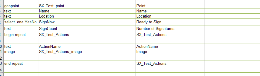

I have put the signature inside a repeat and will use a function to make it visible at the right time - I am using a Yes/No select_one at the moment.
This is working but of course the user is free to add as many signatures as they like, I really only want one.

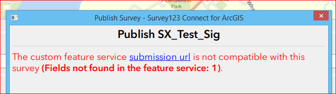

The solution I think is to put 1 in the repeat_count parameter, however when I publish the survey I am getting "The custom feature service submission_url is not compatible with this survey (Fields not found in the feature service: 1)"
If I remove the 1 from the repeat_count then it publishes fine, I just potentially end up with multiple signatures

As soon as I try and limit the repeats to 1 then I get the publishing error
Looks like this:

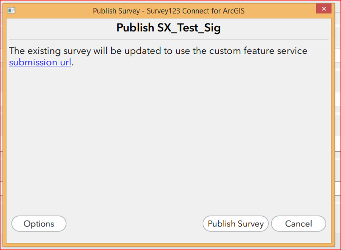

Remove the repeat limit and publish

Hi Steve,
You may need to add a field "SX_Test_Actions_count" to the main layer of the form - when publishing with a repeat_count, an "_count" field is expected.
SteveRichards4
Hi James,
That did the trick,
Thanks very much for your help.

The key to getting it working is that the Feature Service for the main layer must have a field with _count at the end:
Here is the schema for my main layer:
Layer: SX_Test
Fields:
Name ( type: esriFieldTypeString , alias: Name , editable: true , nullable: true , length: 50 )
Location ( type: esriFieldTypeString , alias: Location , editable: true , nullable: true , length: 50 )
GlobalID ( type: esriFieldTypeGlobalID , alias: GlobalID , editable: false , nullable: false , length: 38 )
created_user ( type: esriFieldTypeString , alias: created_user , editable: false , nullable: true , length: 255 )
created_date ( type: esriFieldTypeDate , alias: created_date , editable: false , nullable: true , length: 8 )
last_edited_user ( type: esriFieldTypeString , alias: last_edited_user , editable: false , nullable: true , length: 255 )
last_edited_date ( type: esriFieldTypeDate , alias: last_edited_date , editable: false , nullable: true , length: 8 )
OBJECTID ( type: esriFieldTypeOID , alias: OBJECTID , editable: false , nullable: false )
SignNow ( type: esriFieldTypeString , alias: SignNow , editable: true , nullable: true , length: 500 )
SX_Test_Actions_count ( type: esriFieldTypeString , alias: SX_Test_Actions_count , editable: true , nullable: true , length: 500 ) #It kept saying my field length was too short 500 is probably too big ☺
