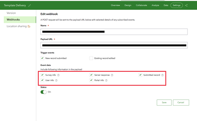

The only thing I could think to check is that you didn't disable Survey info in the webhook itself:
If that isn't the issue, I'd consider contacting Esri Support. Reason being that ObjectID should always contain data, and the Survey Submission connector for Make is something that Esri created.
samc-gis
I've checked the webhook settings and they match your screenshot. I initially wanted to reach out to Esri Support, but need to wait for the MyEsri admin of my client to get back from leave so they can make me an authorized caller - figured I might see if anyone on these forums has experienced the issue before.

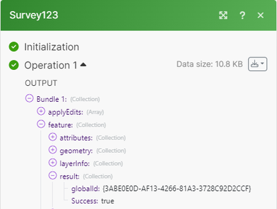

Here is the results section of the webhook payload when a user submits a record from the mobile app - only the global ID is returned:

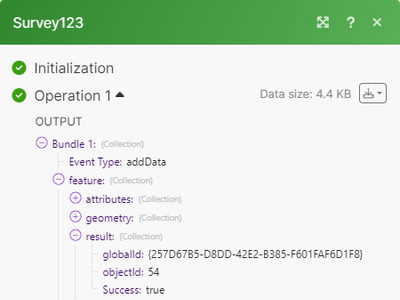

Here is the results section of the webhook payload when I submit a test record from the desktop app - the object ID is included:
I have the Create Report module set up to use the object ID in the results of the add/edit - the issue is that the object ID is not coming through in the results when users submit records or edit records.
