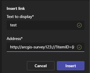

Regular S123 URL in Teams
Also in Teams, but just adding https://
I would suspect that PBI is the same, and it just doesn't recognize the arcgis-survey123 URL, and so doesn't treat it like a URL.
