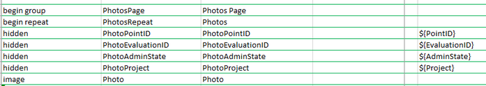

Here is a simple example on our photos form.  Our dashboards and such all filter by State and Project to help our many crews filter down to just their items.  We could do a bunch of arcade for it but then it is really hard to filter on Arcade fields.  Also we use EvaluationID and not globalid (horrible choice) for all our relates later in SQL so we need this key in all tables. So we just add the fields we need at every level we need them, and it all becomes easy.
Main Parent section of form
Repeat child section of form.  Note the simple calc to bring in the fields I need in the repeat.
Now is this double storing data - yes.  Is that not great - yes.  Is a pain to fix if they IDs are wrong - yes.  Is it the only way offline - yes.  In the end does it work well - yes!
