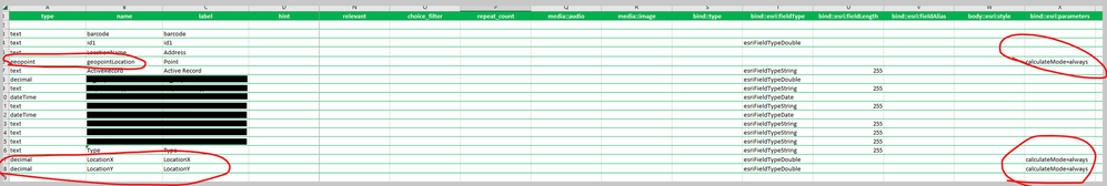

EfeU
Hi @ZacharySutherby ,
Thank you for checking this out! Unfortunately, I've already tried calculationMode=always in the bind::esri:parameters for the X/Y question(s) as well as the geopoint question (please see the screenshots below).
To give a bit more details please see the screenshots below. The very first screenshot shows the existing information of a feature in the inbox (1). When I try to update the location using geocode field (address), unless I click the little refresh button (it appears as soon as I start typing the new address) by the geopoint field (highlighted in the screenshot 2), the coordinates stays the same as the existing coordinates.
Since, my plan to hide the geopoint field for the end user for simplicity, how can I do this refresh in the xls form?
