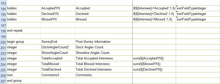

I am creating a creel survey form and am currently having issues using the hidden field type and the bind:esriFieldType.
In my form, I have a repeat question about whether or not each interview was accepted, declined, or missed. I then have three integer fields within the repeat that contain if statements making each of these options a 1 if picked and a 0 if not picked.
If(${Interview}=’Accepted’,1,0)
If(${Interview}=’Declined’,1,0)
If(${Interview}=’Missed’,1,0)
I then have three more integer fields outside of the repeat that take the sum of the total accepted, total missed, and total declined interviews.
Sum(${AcceptedYN})
Sum(${DeclinedYN})
Sum(${MissedYN})
If i leave these six fields as integers, this works perfectly, but I am stuck seeing these fields in my form. I face issues when I try to hide these fields.
When I set the field type to hidden, and then set the bind:esriFieldType as esriFieldTypeInteger for these fields, it does not honor the esriFieldType. Instead, it treats the field as boolean. Instead of adding 1+1+0+1+0+1 and displaying 4, it displays 110101.
I'm probably missing something simple. I've been staring at this too long!
Thanks for the help!

Hi Haley,
In addition to the esrifieldtype, you also need to add a column called bind::type (this will be present starting in the 2.7 templates) and provide the value integer to the hidden questions.  Hidden questions by default hold text values.
JamesTedrick
Esri Esteemed Contributor
Hi Haley,
HaleyNelson
Thanks a million!
