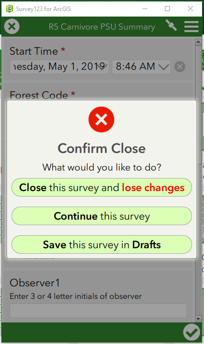

Is there a way to disable the ability for users to 'lose changes' when saving a draft survey?
732
05-01-2019 08:48 AM
KatherineBudreski
Hello!
We would like to prevent users from deleting draft surveys in the field. Is there a way to disable the 'Close this survey and lose changes' option when saving a draft? Also, a way to avoid users from being able to delete surveys using the trash can?
Thanks!
Katie
JamesTedrick
Esri Esteemed Contributor
Hi Katie,
There is not a way to disable or hide buttons for a given survey.  This could be done with a custom version of Survey123 created in AppStudio.  I've taken this down as a potential enhancement to consider; you may want to also post this in ArcGIS Ideas for other people to vote or add their own comments as well.
