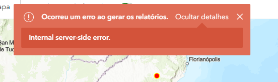

DPU-SMAMUS
Same issue here, im from Porto Alegre, Brazil. The error appeared since 09/09/2024, only on the enterprise
