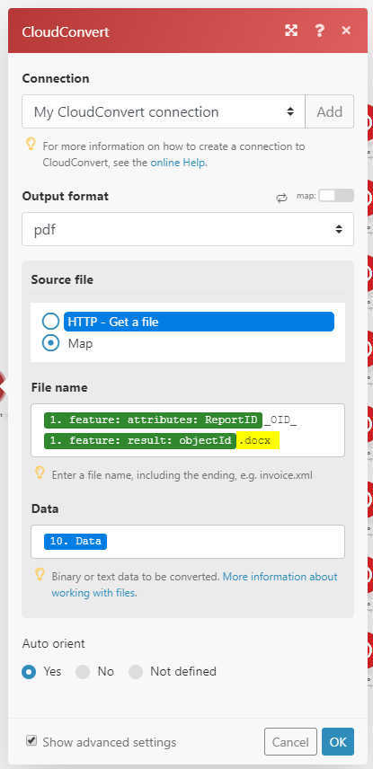

FYI - If you're using using Integromat together with CloudConvert to convert Feature Reports to PDF format, and you want to have Cloud Convert rename the PDF file before sending, you must include .docx after the feature attributes in the File name  section of the CloudConvert module.

Hi @wcozzens ,
Just wanted to check if you knew that Survey123 feature reports can now be printed directly to PDF, and not just to .docx format which previously was the only option. Not sure if this is helpful or would change the way you have set up your Integromat workflow.
