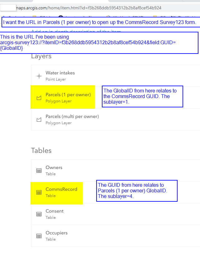

I want the field team to be able to click on a parcel in Field Maps mobile, pop-up appears, and then they click on a link that sends them to Survey123 to open up CommsRecord. At this stage, I want the form to open and be pre-populated with the GUID, so the survey details can be connected back to the parcel. I will eventually want to do this for the three other tables and water intake point. CommsRecord is what I'm focusing on for now.
Question 1
I have loaded 3 layers and 4 tables as a feature service into AGOL. Before doing this, in Arcpro, I established relates. How does Survey123 know which form to open? (I understand we include the ItemID.) In all the integration documentation I've found online, no one refers to sublayers. I'm sure other people must be in a similar situation and have solved it. Once the link from Field Maps opens up Survey123, is it the user that has to take the next step to pick which form to fill out? I hope that's not the case?
This is the URL I've been using
arcgis-survey123://?itemID=f3b268ddb5954312b2b8af8cef54b924&field:GUID={GlobalID}

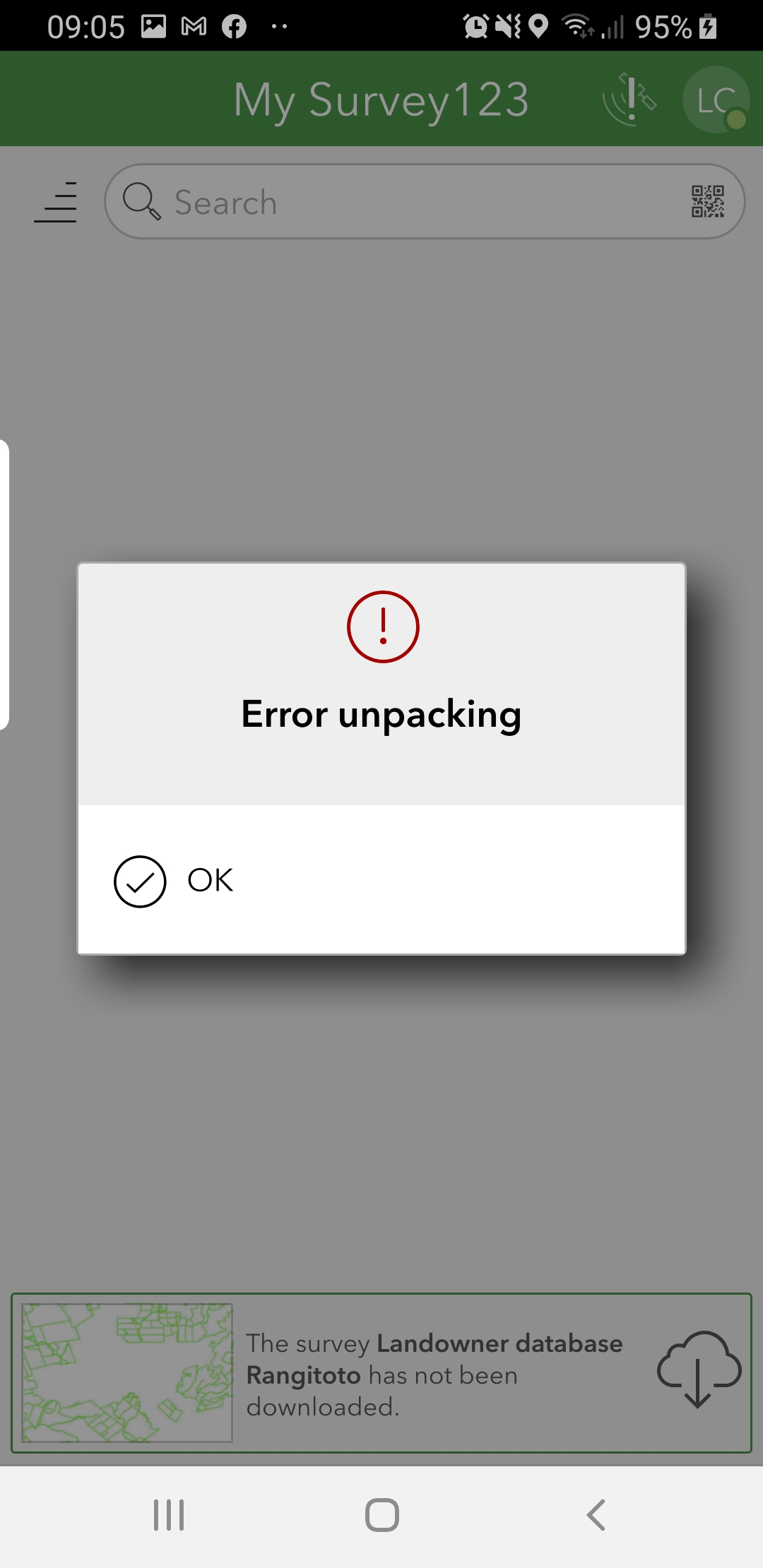

I'm also getting an unpacking error. I can get to the stage where the URL opens up S123, which is good, but then it gives an unpacking error because it thinks The survey data has not be downloaded, however I can see the surveys and open them when not going via the URL. (In the screenshot below, I've deleted the surveys hoping that might clear some ghosts out of the closet?)
Based off of what I've read, it could be because I moved the feature service into a different folder from what it was originally published to, so I will try republishing the S123s into the new location. Do I need to backtrack as far as republishing the feature service from Arcpro?

Thanks @DougBrowning for sharing this. I noticed you shared this with me before on another post, but I didn't fully comprehend it then. Lots to learn about how to use S123, etc. In the end I realised I was using the wrong ID. I was looking in S123 Connect, rather than the form in AGOL that I had published from S123.
For anyone else that may stumble across this post in the future, see post by Mennoter_balls ‎06-26-2017 07:22 AM https://community.esri.com/t5/arcgis-survey123-questions/custom-url-opens-survey-123-but-not-specifi.... That's what finally made things click for me.
