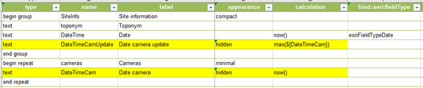

I added a DateTimeCamUpdate field to the parent (made it text and hidden appearance) and used a calculation to get the max() value from the repeat DateTimeCam date field. This will auto update with the max() date value every time a date changes in any of the repeats. I used text fields with the hidden appearance, but you can also use the hidden question type, they are similar, however the hidden appearance is more flexible as it is a real input field in the form, the hidden field type is not. You could also use date fields, but up to you. Note sure if it matters if they are real dates, or just values, as you can also format them using date format functions. If you just use hidden or text fields, in the database they are not true date values, just numeric strings. See attached xlsx file which is my cut down working version.
In the instance name you can then point at this DateTimeCamUpdate field and do the if() calculation and html formatting based on the different date values. Your html was missing the closing syntax for font, italics and bold. I saw in above comments you used some of these, but in your xlsxform the instance name was different, you must have removed or updated it before sending to me. Therefore I just made mine own instance name that was similar to test it works, but update it as needed:
if(today() - ${DateTimeCamUpdate} > 1209600000,concat('<font color="red"><i><b>',${toponym},'</b></i></font>'),concat('<font color="blue"><i><b>',${toponym},'</b></i></font>'))

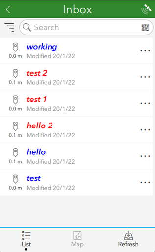

The results in the Sent, Drafts, Inbox etc are colored either red or blue depending on the max date value in the repeats:

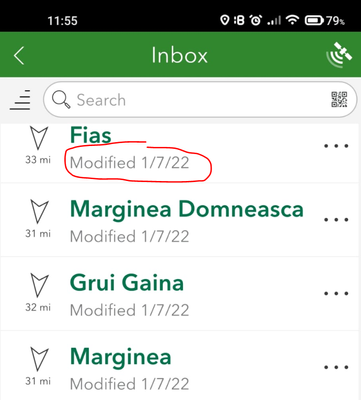

On the inbox already existing a Modified date (see picture below) which is best for me to calculate the age of the last edit date and color differently the instance name title
  • How can i get Modified date into instance name formula?

The modified date used in the Inbox list view is pulled directly from the feature layer and is the metadata field for date modified. This gets updated whenever any app updates or edits that feature. This is not part of the XLSForm and hence can not be used in the instance name, as it is not a referenced field (question name) in the XLSForm.

Sorry for the delay, finally got some time to take a look at your survey. I found a few issues which I have updated in a cut down version of your survey, and fixed the instance name calculation.
