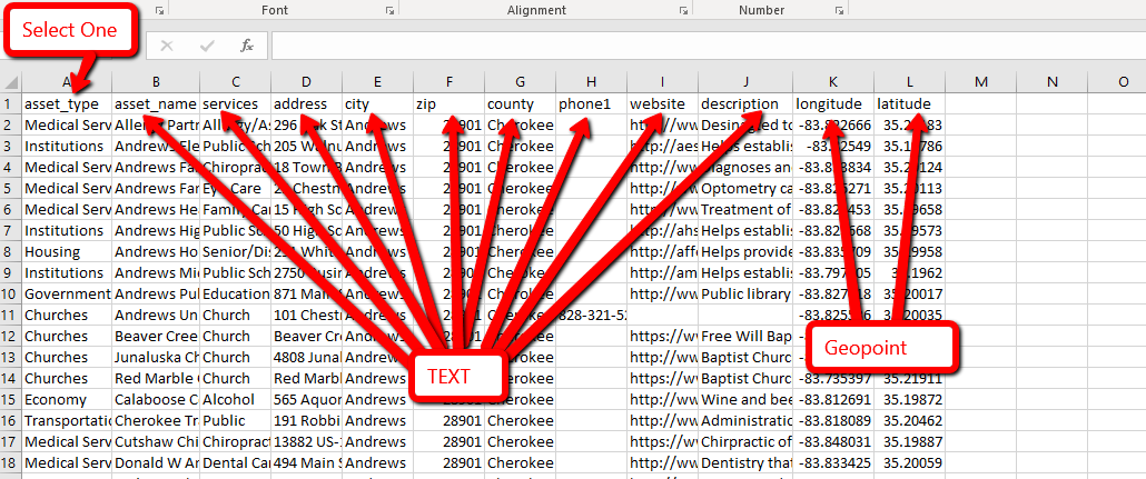

   I am new to Survey123. I would like to import a CSV table into a survey123 survey. The project is about creating a community asset map using ArcGIS hosted services using Survey123. I learned how to create a survey form, but I would have to insert hundreds of records manually if I decide to add them one at a time. Also my table has longitude and latitude columns, is there a way I can set those two columns and have it as a set GPS point for my form?

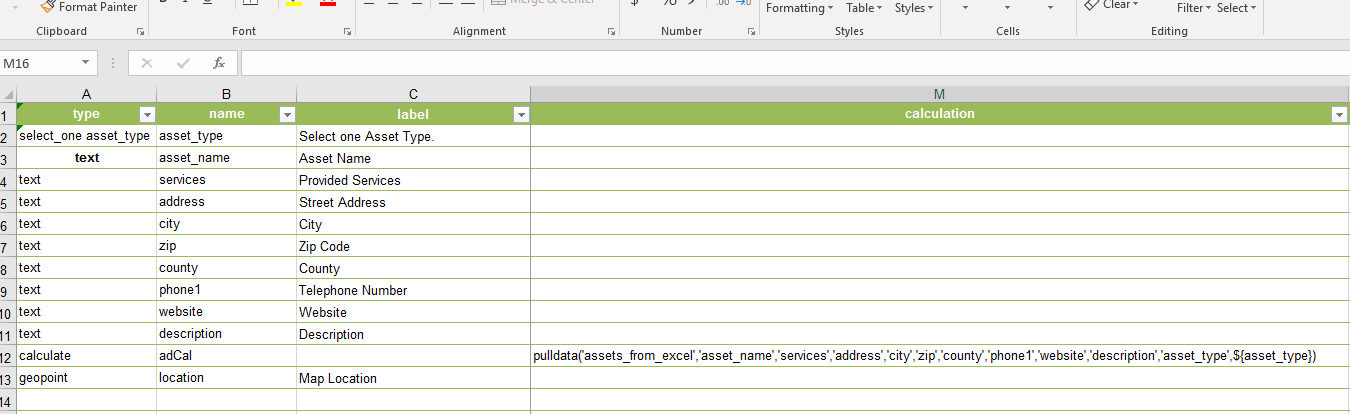

    I tried inserting my table into the survey media folder and then use pulldata functions to insert my data into the survey form. But, I think I am doing it wrong and I can't figure out how to set the my coordinate columns into a geopoint.  Any help will be highly appreciated.

This is what I have been able to do so far, but the csv data is not linking with the survey form
geonet2

Your problem with the pull data is you are trying to pull all the data in one field.  It doesn't do that.  So, rather than that you need to make a few changes.

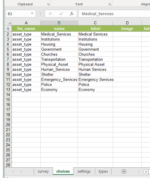

First, your calculation won't work as you are trying to use the label and not the name in your csv file.  You need the asset_type in your csv to be the same as the name column in your csv.  Otherwise it will never find a match.
Second for each row in your xls where you want to pull data you need a separate pulldata calculation in the calculation column .  For example the calculation for the city row would be pulldata('assets_from_excel', 'city', 'asset_type', ${asset_type}). The type of question can remain a text row but I would question if this is what you want.  Do you want them to be able to write over what is pulled from the csv?  If not you need to consider setting the question as read only or changing it to a calculation type with a note type following showing the value or simply as a note type where the data would then not be stored in the table.  It can get quite convoluted (which is due to the power of Survey123) but it becomes really important to think about why you are pulling the information.
