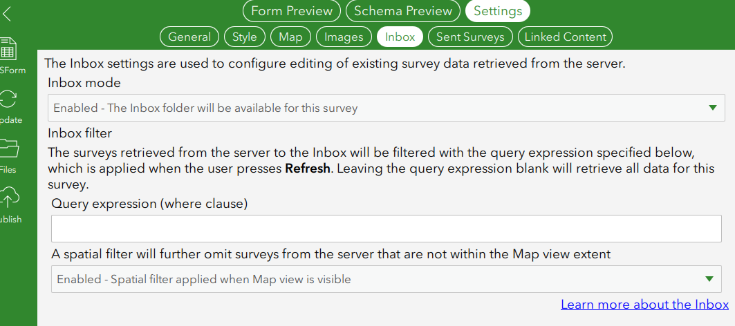

You could enable the Inbox mode from Survey123 Connect to allow your field worker to access to the collected data and then can modify the existing data and records from the Inbox in the field app.
Prepare for editing existing survey data—Survey123 for ArcGIS | Documentation
