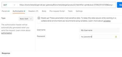

I am not a programmer so bear with me. I just did what Zach suggested and used Postman to setup the HTTP basic authentication method
And then copyed the code from Postman to the Script in Survey123:
Don't know if this was any help at all.

Understood that you're not a programmer. Do you know how you've set up the username and password in that in order to not expose it publicly? The part that I'm most concerned with is the part that's cut off in your screenshot.
