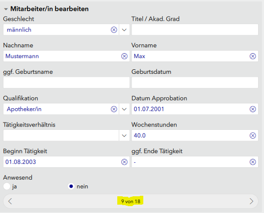

I have a repeat section within my survey. This repeat section is supposed to be inserted into a dynamic table in the report.
The survey user first selects an object outside of the repeat section. Each object has a different number of employees, whose data is output in the repeat section via CSV. By selecting the object, I determine how many records the repeat section will have (repeat_count).
Using position(..) and the corresponding reference in the CSV, I can prepopulate all records.
(For example: record 9 out of 18)
The survey user has the option to edit these records if, for example, information is missing or needs to be corrected. However, the user should not have to go through each record necessarily.
For the report, I have noticed that apparently, I need to go through each record to ensure all records are included in the report? So if I do not touch the repeat section at all, only the very first record is output.
Is there a way to avoid this process so that all records from the repeat section are inserted into the table, regardless of whether I go through them in the survey or not?

Hmm. From what I understand from your issue, I believe the answer is "users need to manually go to each repeat page".
Your repeat appears to be all calculates. And (very unfortunately) repeats only execute calculates for the "active record", which is always going to be the first repeat record. Your users need to scroll to each tab to ensure that the data gets loaded.
