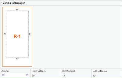

Would it be possible to just show the image without using an Annotate appearance? I have .jpgs of zoning setbacks, which I want to display only the relevant .jpg based on a previous pulldata() that intersects the location with our zoning service. For example, if the location is within A-1 zoning, the setback diagram for A-1 zoning would display below, without the user having to annotate the image.

Hi @BenBaker1,
You could display the image in a note question if you just want it displayed in the form but not editable, and that can be relevant/calculated based on previous questions.

I was able to get something close to what I had in mind using the following:
The setbacks are pulling from CSVs in the media folder and the image filename is constructed from the zoning plus ".img" to display it in the note. The images are also in the survey's media folder.
The end result looks like this:
