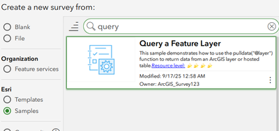

Thanks for sharing. Since the examples are for point‑in‑polygon, could you provide an example of querying a point feature using a GeoPoint or GeoSHP?
