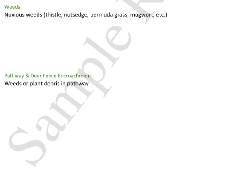

My feature report for inspections references a feature layer and the most recent related record. It has over a dozen categories that have fields/questions ranging from optional open text boxes, multiple choice select, and photos.
I am able to use if statements around grouped questions so they do not show if not filled in, however, it results in a lot of empty lines in between sections (See attached image at the bottom). I have put if statements on the same lines where possible but still results in a few lines per question on the backend.
Alternatively, can I instead format it so if it exists, include the value, if not, print "N/A"? That way the report would look a lot cleaner and provide clarity. However, with this I would also like to mitigate any blank lines. This in particular would be helpful to note for general categories that there is nothing filled for its subquestions. For example: Misconduct - N/A

Hello Katherine, thank you for your response! I tried your N/A line but got the following error:
Error: An error occurred when checking the report template. Failed to parse ${# if'($true$) if weeds =='''} undefined
Attached is a snippet of my report template. Both are repeats. Those two examples apply to the rest of the ~15 questions. So then, for example, if no answers were provided for 1) weeds, and 2) diseases, pests and chemical use, then there would be lines of blank space until questions that contain answers. If you see my initial screenshot, there are two questions between "Weeds" and "Pathway & Deer Fence Encroachment" that are empty that result in those lines in between.
Any help is much appreciated, thank you!
