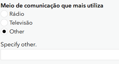

Hi there!
So i have this situation where i want to translate to portuguese the alternative name of specify other. This is a field generated automatically by the fields  select one or other.
I wanna translate the "other" title, and the "specify other".
Would be nice if someone could help me on this one.
Thanks in advance!

Hello @Luwerli
This is a known issue and is highlighted in our documentation. What I would suggest as an alternative workflow is not to use or_other, but create an "Other" question that is relevant based on the "Other" choice, that way you can localize both the choice label and the relevant question label.

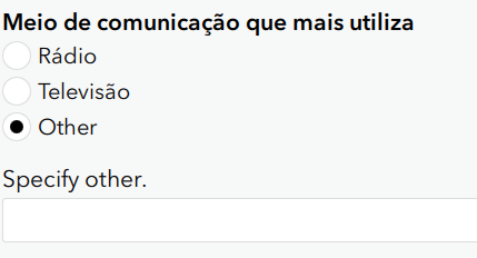

ZacharySutherby
Hello @Luwerli

Luwerli
Hi Zach,
thank you for your answer!
I was wondering if there was a easy way to solve this situation. It worked out  for me.
