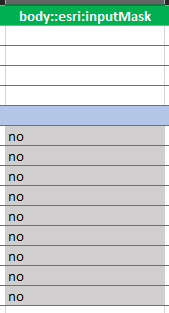

Your actual survey seems quite straight forward - i do however see that you have an input mask on the hidden fields - is this by design or by accident? I'm not sure but perhaps that could cause an issue?

I don't even remember what that's supposed to do.  What does 'no' mean here?

no is not even valid here.  Prob did a copy paste and got it wrong?
