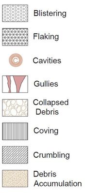

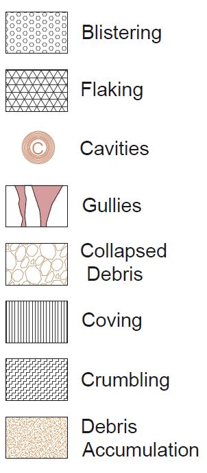

Dear all,
Please may I know if it's possible to add the hatch pattern Custom palettes for image annotation in Survey123?
if not, please may I know if it's possible to use Puyton or script to add it, or if there is a plan to add this feature in the next releases?
please find below picture includes some of the hatch pattern that I'm looking to add them to the custom palettes
Thanks

Hi @TariqAlhammadi,
The custom palette only supports setting a color as the fill symbol. The reference tab of the custom palette (attached) shows the supported fill symbols.
Support for pattern fill symbols isn't currently a planned enhancement, but you may want to submit the idea in ArcGIS Ideas so interest in the feature can be tracked.
