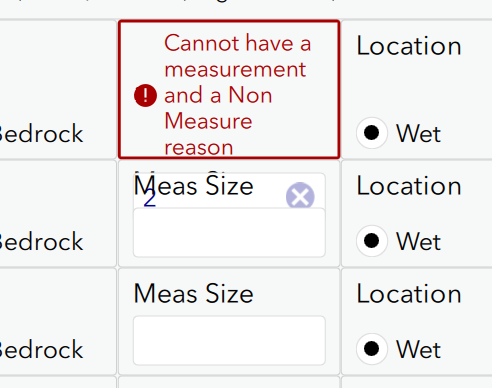

Other issue with grids is the constraint messages.  It tries to squeeze it in there, which messes up the field to the point of the user cannot change the value.  You cannot click on the X or anything.

Designing an effective Grid survey requires you to be mindful of your user devices. Could you consider using the default constraint message and then displaying the full constraint failure message as a note in a separate question? Obviously, making the constraint message shorter or the grid cell larger may also help here.
The long constraint message is pushing the input box outside of the grid cell, messing up the form. The correct behaviour occurs on the second and subsequent submit attempts, ie the cell expands to accommodate the custom message and the input box. I’ll create an internal issue to investigate a fix. It would be great if you could also contact the Support team regarding this so they can assign an official bug number that you can track. If the issue is reported by other customers, it will be attached to the same bug number. This helps us understand the impact of the issue and prioritize it accordingly in our development plan.

On errors how about highlight the field in red but then put the message at the bottom?  That way we could always have long messages without issue.  Just an idea.

The in-line validation messages were a much requested feature that was implemented in 3.5 so I don't think we'll go back on that feature. I think the fix is straight forward for this as the correct behaviour is happening on the second submit attempt. We just need to get that behaviour to happen on the first attempt! Raising this with support so they assign a Bug number will help get this prioritised.

I mean you could highlight the field in red but put the message in a standard spot at the bottom or top.  That way the message area is always the same size.  The way it is now means I have to have short cryptic messages or break my form.
