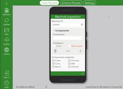

Using a join like this on the image above would probably make it work but I don't know how to implement this.
https://community.esri.com/t5/arcgis-survey123-blog/survey123-tricks-of-the-trade-repeats/ba-p/89804...

Hi @IniobongBenson,
Yes, you can do this using a constraint in the main layer referencing values from the repeats. Add a count in a hidden field that will check each repeat and either count a question or do a string-length > 0, to ensure there is an answer in that question and returns a 1.
Then sum or count the 1's, and if they match the number of repeats, the constraint will be met, if they do not match, it means one of the repeats is not answered. This will cause an error and the form can not be submitted.
Please refer to https://doc.arcgis.com/en/survey123/desktop/create-surveys/xlsformformulas.htm for supported formulas and functions, including the newly added functions for position and indexed-repeat, which you may find useful to query each repeat for specific values.
