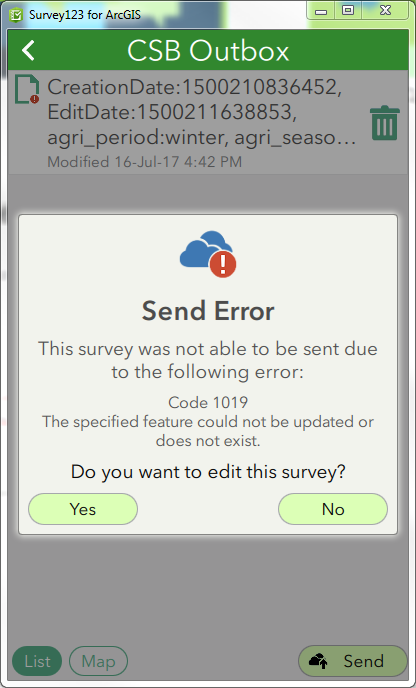

Hi,
I am getting error code 1019 "The specified feature could not be updated or does not exist" in Survey123 for ArcGIS (version 2.2.14) when I am trying to edit existing survey data using the Inbox functionality in the Survey123 for ArcGIS mobile app (tested in Android and Windows OS - version 2.2.15).
I am using Survey123 via AGOL and checked the survey data through survey123.arcgis.com, I was able to edit the data thorough AGOL Web Map viewer and the updated data is reflected back on survey123.arcgis.com.
Any help on this is highly appreciated.
