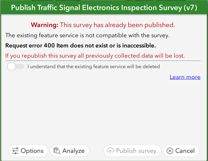

Getting Error 400 Item does not exist or is inaccessible in Survey123 Connect when go to publish survey

I was having issues with some of my fields not showing up after I made some changes to my survey.  It's still in the testing phase, so I went ahead and deleted the form, layer and map, from within AGO along with the folder these items were stored in.  When I went to republish my survey, I now get the following error:
I found a post from another user who had a similar issue and the solution was to delete the file within the survey folder that has iteminfo at the end of the file name.
I deleted that file and then tried again to publish my survey and still get the same error message from above.  Any help would be greatly appreciated!

If you deleted it then its confused since it is not there.
Quick way around it is to
Close Connect
Go into the My Survey Designs folder and find your form.
Rename the .iteminfo file to say OLDname
This will wipe your name, and other settings so reset that.
Now you can repub the form and it will make all new form item, feature service, etc.
Hope that helps
Other option is to say New Survery from file and pick your xlsx.  Then add the media folder over from the old form manually.

Bec
Doug,
Thanks for saving me from my rookie mistake!  I did as you said in the above reply and was able to successfully submit my survey again.  My other option was just to make a copy and change the name slightly, which would have worked as well.  Thanks again for your help!

Hi renamed the Item info file. But when you said "This will wipe your name, and other settings so reset that" what reset are you referring to. I currently now have the old name appearing but I also have a duplicate of the new name there aswell.
DougBrowning
MVP Esteemed Contributor
The description of the form and such in Connect get wiped.  Just add them back in.
