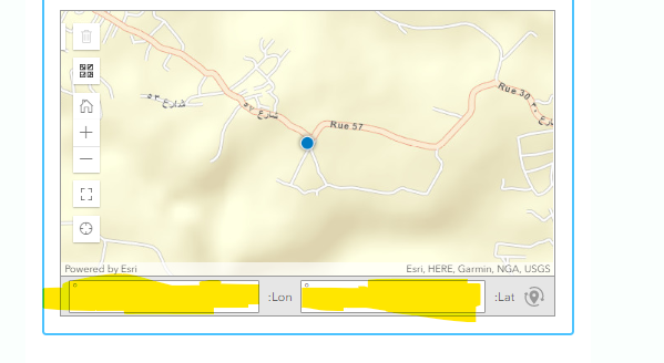

I’m facing this issue when publishing a survey from survey123 connect with read only and required geopoint  and viewing the form in Survey123 web .
As you can see in the attached photo  ,  in read only mode I can locate my self , but no long and lat values are passed .

Hi Hassan,
In the context of the web form (which does not auto-record a point location), a read only geopoint question is not appropriate unless passing in a location via a URL parameter or calculating the location based on other questions.

Hi James,
I republished the Survey with version 3.7  and its working now . I can capture the location with readonly mode .
