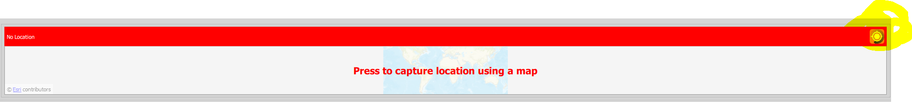

Geopoint field automatically begins to pick up location (spinny thing - spinning)...

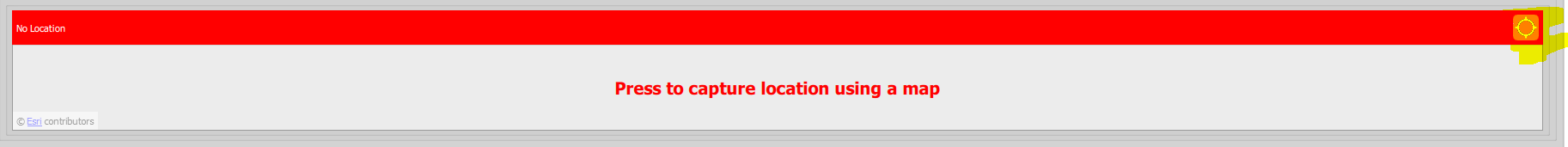

Geopoint within a repeat does not automatically attempt to acquire point and waits for user interaction (spinny thing - not spinning)...
I would like the repeat to behave the same way as the non-repeat geopoint.  Is there a way to force the geopoint to begin acquiring a location in a repeat?
