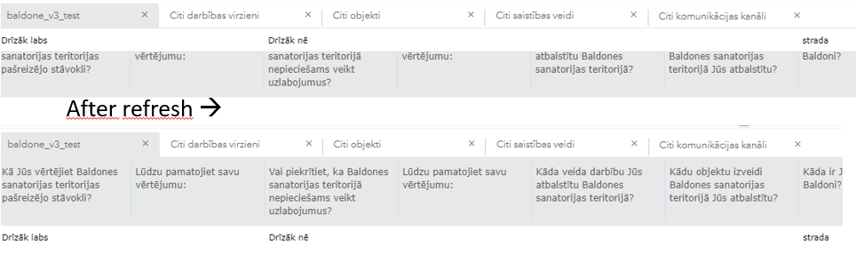

PS I can see that there is an unusual behavior in the 'Data' section on survey123.arcgis.com regarding the way it shows data table and field names. I attached an image. I am not sure if this might already be detected...
s123_data_view_shifted
