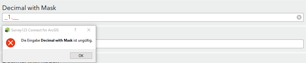

Input Mask
The input mask enforces the answer to exactly match the mask, i. e. the value 1 for the input mask 99.99 would require the answer 01.00, otherwise the answer fails validation.
