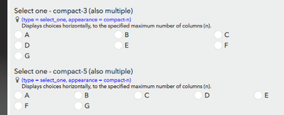

@VickiG I love the autocomplete too, but if you want them all to show, you might like this option.
in the appearance column type in: compact-5

Thanks Mobius and Michelle for the great suggestions.  I will play around and see if these might help the workflow.  Just trying to avoid endless scrolling and crabby field biologists 😉
