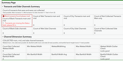

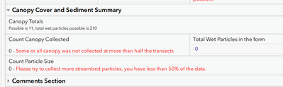

I do this with a Summary page as the last page of the form.  Some are warnings in red font and some are hard stops.
I also do some inline emojis so the user has instant feedback vs waiting until the end.  I have a how to post on this.
Hope that helps.
