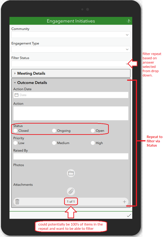

I have a repeat for actions/tasks with a status question (open, closed, ongoing).
I want to be able to filter the repeats by having a question outside the repeat that filters based on status i.e. Filter Status with options of All, Open, Closed, Ongoing.
Is this possible?

JamesBailey
Please see below photo, hopefully it explains my situation a bit better.
If I am missing an obvious solution with a different method I am all ears.

ZacharySutherby
Hello @JamesBailey
To define the number of repeats you would use a repeat count. One thing to note on repeat counts is all repeats defined by the repeat_count value must be navigated through before the survey response is submitted; otherwise, not all repeat records will be submitted. To ensure that all repeats are submitted, consider making questions required in your repeats.
I have attached a zip file that contains a sample that uses pulldata to define the repeat count based on the filter status.
