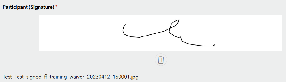

Survey123 App (filename visible below signature)

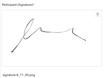

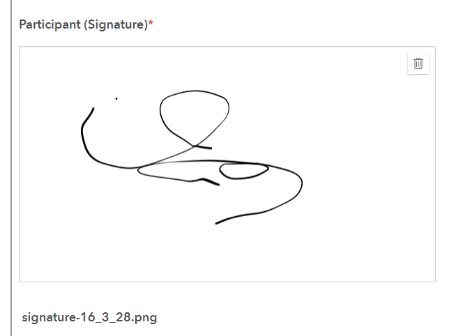

WebForm (filename visible below signature)

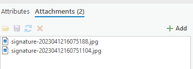

Viewing the HFL in Pro

Additionally, in everything apart from the S123 app, the filename field that I made visible below the signature returns a generic filename.
S123 App
Any Browser - Mobile or Desktop
