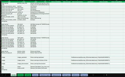

Using Survey 123 Connect version 3.17.55.0 to design the survey I've been trying to implement specific file names for images related to a Survey Point ID Reference(Label) or survey_ID (name).
In fact I'm taking three images at each specific survey point, an Upstream, Downstream and Centre and they are all related to the same survey_ID. However when I have tried the various versions as illustrated in the following links i cannot get them all to work. Often only one will work and the others are default names.
https://community.esri.com/t5/arcgis-survey123-blog/what-s-new-in-arcgis-survey123-june-2022/ba-p/11...
https://community.esri.com/t5/arcgis-survey123-blog/survey123-tricks-of-the-trade-set-the-file-name-...
https://doc.arcgis.com/en/survey123/desktop/create-surveys/xlsformmedia.htm#ESRI_SECTION2_D007264B8F...
Yet I seem to get nowhere when running the published survey on the field app and end up with just a default name for each image.
What I'm trying to achieve is something like "Dee_05_a_image_downstream_20230517-233210.jpg" and "Dee_05_a_image_Centre_20230517-233215.jpg" etc.
Here is the XLS form survey data I'm using.
Any pointers would be most welcome.
Best regards Jamie
