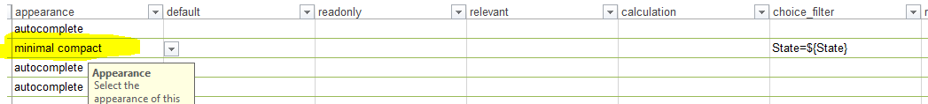

We have too and I'm going to start a support request this morning with direction from Ismael Chivite‌.
However, we have discovered that it is tied to the {appearance} type that you are using for the question. If we change our type from the {autocomplete} to {minimal compact} then our functionality of the choice_filter is restored and works in full.
I hope this helps you out.
Mike
FrancisMalik
Thanks, Mike. I'll use this workaround until that appearance function is working again.
